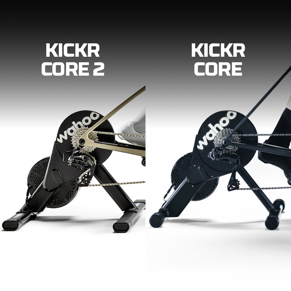

KICKR CORE 2
KICKR CORE

How does the KICKR CORE 2 leg design differ from the original CORE?
The KICKR CORE 2 features flattened oval legs with color-coded components and offset bolt holes that can only be assembled in one direction. Unlike the original CORE, the new design allows you to set the trainer on the bars and then fully tighten the bolts, and the bolt holes physically won’t align if assembled incorrectly.

What flywheel changes exist in the KICKR CORE 2?
The KICKR CORE 2 features a redesigned flywheel that simultaneously lowers the overall product weight while slightly increasing the inertial load. This creates better road feel and more realistic ride simulation compared to the original CORE’s 5.4kg flywheel.

What are other KICKR CORE 2 improvements not commonly mentioned in third-party reviews?
The KICKR CORE 2’s simplified four-bolt assembly includes color-coded chevron artwork on the feet and mounting brackets that ensure correct alignment, and the packaging design reduces setup friction with easier unpacking compared to the original CORE. The leg design prevents incorrect assembly through physical constraints rather than just visual guides.
