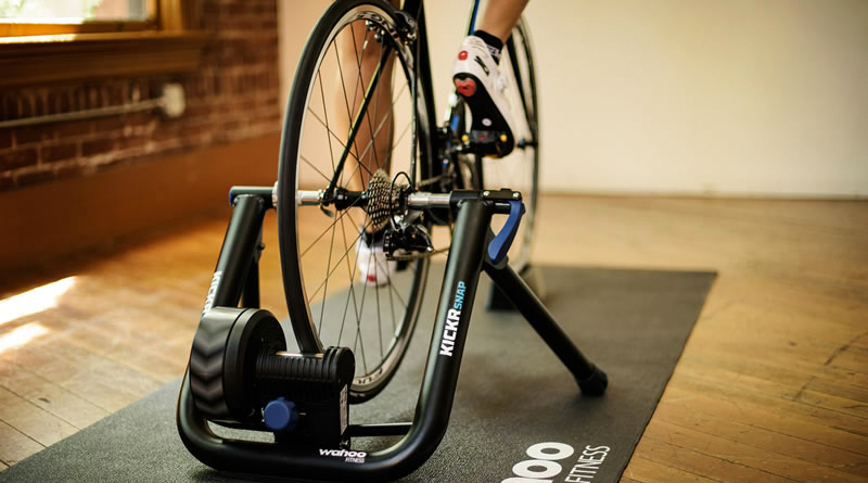

Example of Wheel-On Trainer: Wahoo KICKR Snap
The Wahoo Kickr Snap combines the convenience of a wheel-on design with smart trainer capabilities, offering cyclists an accessible entry into the world of interactive indoor training. Its easy setup allows you to quickly attach your bike without removing the rear wheel, while the automatic resistance adjustment feature seamlessly integrates with popular training apps like Zwift. This integration enables dynamic resistance changes that simulate terrain and workout conditions, providing a more immersive riding experience. Built with durability in mind, the Kickr Snap’s sturdy frame can handle power outputs of up to 800 watts, making it suitable for most training sessions and riders.
